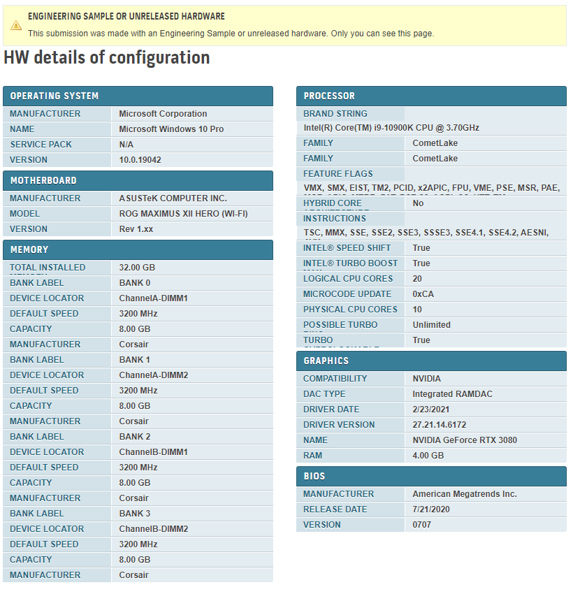

Can someone tell me what this is? I bought a brand new unopened i9 10900K avengers edition from a reputable store. Why am i getting this ?
Also HWBOT wont let me in the analyze and compete sections because they are greyed out even though ive done the XTU benchmark. Is that related to the ES marking ?

If it was an ES or PP processor, then this report would have said so. It doesn't, so you are ok.

If it is an ES (engineering sample), take it back to this reputable store.  You can also take a photo of the top of the processor and post it here.  It could be that your utility has made an error.

Thanks, i looked at that picture of the ES CPU in the link you provided but mine definitely says Intel Core i9 10900K on it.
If it is the XTU utility that has made an error, is there any fix for it?
I should also add that im in a older ME, not the newest.

Download and run the Intel Processor Identification Utility. It will tell you if you have an ES or PP processor.

Thanks, here is the .txt file from Intel Processor Identification Utility. Not really sure what i am looking at.

There are multiple reports on this issue over at HWBOT forums too. Seems to be the XTU software that is doing the error.
