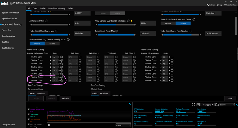

fredde23
10,245 Views
My cpu crashed also completely random underload and i found a fix by lowering down the active core tuning by 1 unit
K03212
10,238 Views
Sadly, that will not fix my issue. I already tried to run every performance core on 5 Ghz already. Still crashed on both systems...
