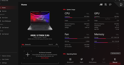

I am also facing this problem. I just bought a Rog Strix G615JHR on 5th August 2025 with an i7 14650hx and an rtx 5050, it idles at about 55 to 60 degree Celsius and whenever i open valorant or even any other games like gta v or mw3 or battlefield 6 the temp goes up to 95 sometimes even 97 but this happens only when i put the laptop in turbo mode but the gpu temp always stay around 60 to 75 degrees even with ultra settings in the above mentioned games. Asus said this temperature is fine they did not find any heating issue with the laptop and closed the service request. Asus said this laptop has a liquid metal thermal compound and the fans run at 5800rpm max. Is this an issue with the processor?
Hi @Omiiid,
Thank you for your updates.
Based on the information provided, It appears we do not have access to the unit in question to conduct further investigation. Since it is coordinated with the manufacturer as outlined in the article My Laptop Seems to Be Overheating, I’m unable to comment on your readings. I rely solely on the Intel® Processor Diagnostic Tool to determine if a processor is faulty.
Beyond this, the manufacturer is best positioned to assess your system and provide detailed explanations regarding the readings you mentioned. I’ve already shared all relevant articles related to this concern, and with that, I will proceed to close this ticket.
