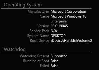

There could be an option "restore tuning after reboot" in general settings > advanced options, can you check if your XTU version has it?
Jocelyn M.
It seems there isn't such option:
