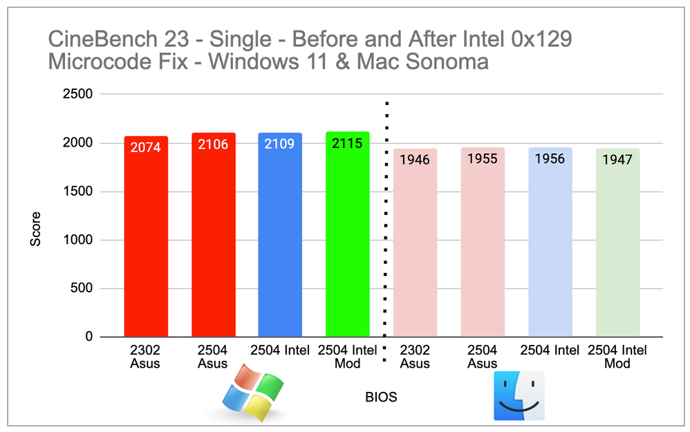

BrianMH
16,722 Views
Asus 2504 BIOS with 0x129 Microcode working just fine, no issues at all with 14700K, Asus Z790 ProArt Creator.  Though I did set AC LoadLine to 0.1 as opposed to 1.1 default, disabled IA CEP and ATB.  This got me an undervolt (the AC loadline lowering) that results in much lower temps and power compared to Intel Baseline and also gets me performance similar to Asus Enhanced OC profile.  Without these changes the Intel Baseline Profile still has thermal throttling. So all in all situation is totally under control.
I tested in Windows 11 and Mac Sonoma.  Yes - I have Sonoma running with this CPU/motherboard.
I even made a video about the fix and my test results:
https://youtu.be/J2k9_dqKlnw
Here are some of my results:
GeekBenchSingle.jpgGeekBenchMulti.jpgCine23Single.pngCine23Multi.pngCine24Single.pngCine24Multi.pngPackageTemp.pngPackagePower.pngVCore.pngfinal stats cropped.png
