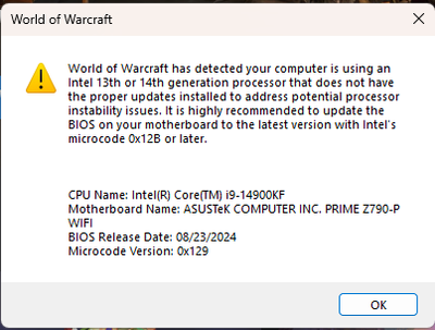

I'm in need of desperate help as I've purchased a PC from Best Buy the past year or so & it's starting to just crash my games or apps constantly to the point I had to pull out my old PC to do anything.
I'm not the smartest guy or Tech Wizard so anyone with knowledge on what's happening & how to get this fixed would be greatly appreciated!
I've attached the consistent popup for one of my top games World of Warcraft & the updates page on intel stating everything is up to date.

What's happening here is that you need to update the ASUS BIOS and some associated drivers. The Intel utility does not work for these but there is a reasonably simple way for you to carry out these updates using ASUS DriverHub.
ASUS DriverHub is a web based utility that can be found at https://driverhub.asus.com/en . This page will initially scan your system to verify that you have ASUS hardware. It will then offer a download which is a download of the ASUS DriverHub Windows App. Install and run the App - you will get the scanning message again and it will send you to the web page where there should be an Available Updates tab.
The Available Updates tab will include a whole list of things, some of which you should not need. This includes Intel Rapid Storage software, AI Suite 3, Norton 360 and WinRAR.
The rest will be items that you should select to install and installing them should solve your problem.

There are two issues here.
The warning message from World of Warcraft is because you are not using the latest BIOS from ASUS. I have established that ASUS DriverHub only does drivers, it does not update the BIOS.
Updating the BIOS is covered by the detailed advice from ASUS that can be found here .
The ACCESS_VIOLATION crashes in World of Warcraft seems to be a known issue. Some sources say they are driver related but you have updated  your drivers and presumably restarted your PC so that seems less likely. The NVIDIA driver is the latest I take it.
One of the issues with Corsair Pre-built machines like yours is that the advice is to use the standard ASUS drivers because you have an ASUS motherboard. And Corsair support the use of some of the ASUS utilities such as Armory Crate.
So I am inclined to say that you probably should contact Corsair support and see what their advice is.

So I was able to find the BIOS download & looked to be the proper 0x12B. After going through with the update it finally worked and went through but then it said it was resetting my PC.
When it did so the power button began rapidly flashing & slower after awhile but my monitors weren’t showing anything. I waited about 15 minutes before turning off the PC for about 5-10 minutes & when I turned it on again the same thing happened.
What do I do now? Nothing is showing onto my monitors but my PC is on along with the monitors themselves.
EDIT: Took a few tries of turning it on & off between 5-10 minute intervals but it finally booted up properly. I double checked the system to ensure the BIOS was updated & sure enough it was. After doing so I attempted to get on World of Warcraft & for the first time I didn't receive the popup notification! Not wanting to jinx it so knock on wood but I believe this helped with my issue. I'll be test playing multiple games to see if any crashes or the like occur & go from there.
