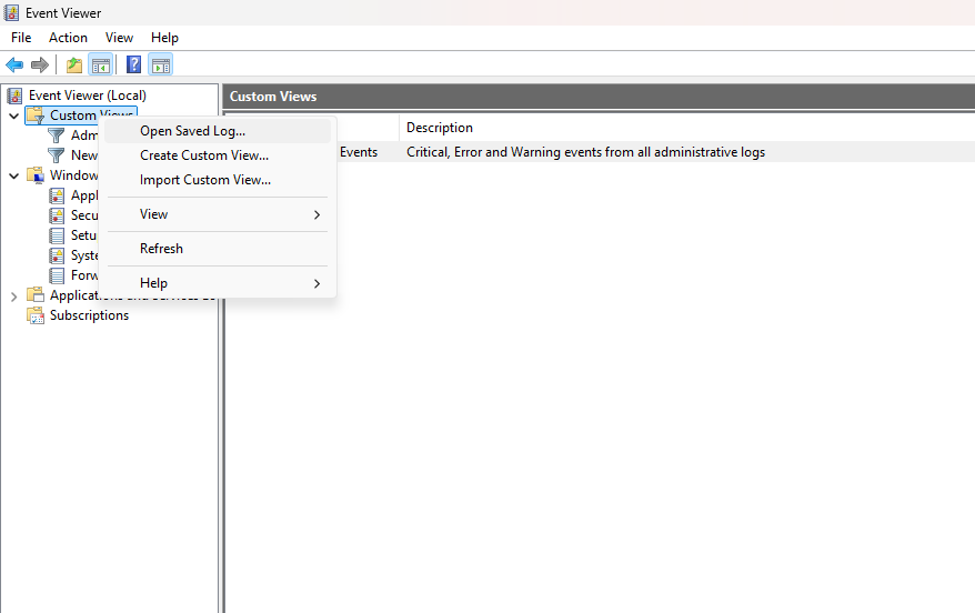

Open Event Viewer
Right click on Custom View and select "Create Custom View"
Then, change the setting from "by log" to "by source" and select WHEA Logger from the pulldown.
Click OK and then give your custom view a name and a description and click OK.
You can now look under Custom Views to see only WHEA errors.

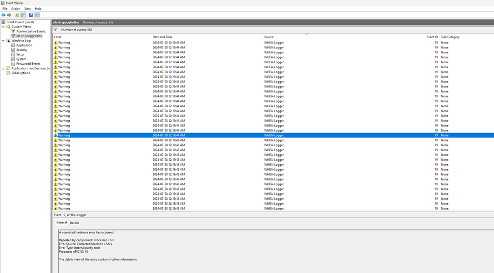

Look for chain errors like this especially where rapid-fire errors occur. However any errors are bad. This is somewhat mitigated by the 0x125 microcode and Intels power settings and if you've kicked these errors before you can try inducing them again by trying to raise your PL1/PL2. It should start failing again.
Look for the following,
  • Translation Lookaside Buffer Errors
  • Cache Hierarchy Errors
  • Internal Parity Errors
If so, is the APIC ID involved one of these, but most likely a combination or all of them?
  1. APIC ID 48
  2. APIC ID 40
  3. APIC ID 16
Then please chime in.
If you are experiencing Event ID 17 for PCIE Root, or the above errors on different APIC IDs, please state so. That information is also relevant.
