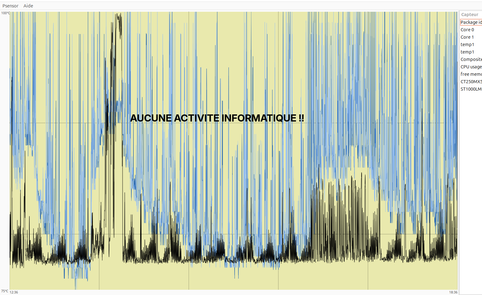

Hello Michael
Thanks for the suggestion. At the moment, because of this overheating and high cpu load, I'm using my old, less powerful laptop.
I'm wondering if the problem isn't with the link between my SSD external portable hard drive and my mini-pc.
I'd like your advice on whether I should reconnect this disk to my Intel NucPro mini PC before running the analysis. This data disk contains all my application data (appImage, Firefox and standalone Thunderbird ..).
Why do I make this assumption?
Using another laptop much less practical than my NUC Intel Pro mini pc, I notice that cpu usage and temperature fluctuate a lot without the data disk plugged in less. If I plug in the data disk again, the temperature and cpu load regularly rise to the maximum!
I'm making a new hypothesis, because if I plug this disk back in, it goes haywire again!
Characteristics of my SSD :
SSD LDLC SSD F8 PLUS M.2 2280 PCIE NVME 120 GB - SSD 120 GB NAND 3D TLC M.2 2280 PCI-E 3.0 4x NVMe
Read max. real ext. ~1500MB/s (theo.: 1700MB/s) ; Write max. real ext. ~ 525MB/s (theo: 600MB/s) - access time 0,02 ms - https://www.ldlc.com/fiche/PB00263753.html
This SSD is currently working perfectly well on my lenovo laptop with a temperature that doesn't exceed 50°c and 15 to 20% cpu.
On the 2 computers, I have the same ubuntu 25.04 version, the same applications, data ...

Hello Michael
Thanks for the suggestion page. I took the time to retest but there's no improvement
Were you able to take the time to look at the logs?
what do you think of my hypothesis?
I'm also attaching images that show the evolution over time as I hardly use NUC INtel por but my lenovo laptop. What do you think?
