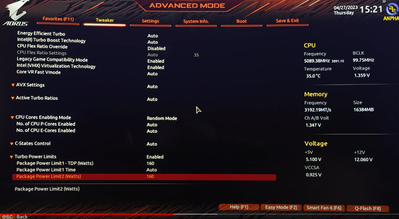

TanPhan_CG3D
20,914 Views
hi,
I am also using cpu 17 14700K (mainboard auros z690M elite)
When rendering in cinebench, Blender, Maya... I also see the temperature rising to 100 degrees (my job is often rendering, so I need the temperature to be reduced to 80 for safety reasons, long-term use, I have Acceptable reduction in CPU performance)
This also makes me very worried about my PC.
I have researched many YouTube channels about how I optimized the i7 14700k, by limiting the voltage for Vcore, but it seems I have failed, sometimes I can't render to check the results of the changes in the bios, sometimes then the engine turns off, freezes...
I tried to find a way to update the bios, but it didn't work, it got a blue screen after updating, so I'm also asking and asking for advice from customer support at gigabyte.
1 - Today I want to ask what parameters should I change in the bios to limit the voltage and temperature of the cpu?
Can you help me list the necessary parameters to change?
I have attached a photo of some of the changed parameters, in which the internal cpu Vcore offset is 0.12 Volt. Is it good to increase or decrease it to check which level is best? How many volts should I increase or decrease each time ( for example 0.125 or just as small as 0.121)
2 - There is a YouTube channel that shows how to change the tube's power limit (160 - 160 likes the second photo).
it doesn't make any sense and I would prefer to limit the voltage and temperature to a safe level below 80 degrees
3 - if i work at "intel Extreme Tuning" software
So what parameters can help me limit the temperature, while still maintaining the same performance? Or if just limiting the application power and temperature will reduce the CPU's performance?
