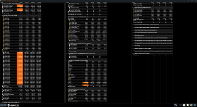

Hi there,
- CPU: i9-14900KF
- GPU: RTX 4080
- 32 GB RAM XMP1 6000MHZ
- MOBO: Gigabyte z790 Gaming X AX
- PSU:  Seasonic VERTEX GX, 80+ Gold, 1000W PSU
- AIO: NZXT 360 KRAKEN
So I built this PC in December 2023, and at first it worked perfectly, no errors in games, good temps, everything was smooth. However, a few months ago, I received an error (out of video memory) while trying to play Fortnite, and BF2042 was also crashing.
After some research I found the issues with i9-13/14 gens, and went into BIOS to set up PL1+PL2=253W, ICCMAX=400, MCE=disabled. This thing fixed my issues with these specific games, but today while trying a new game (The First Descendant) I crashed at the shaders screen with the same error as months ago (out of video memory).  The only thing that seemed to fix loading the shaders was to lower my resolution to 1080p and all graphics on Low, and then I reverted them at default.
Now I'm afraid that my CPU is degrading, because I tried running Fortnite again and it crashed, but after another try it worked well. Same with BF2042, after a session I noticed in HWINFO that my CPU went to 92° lol. Max I had was 80-85. This is probably because of the hot weather right now here (35° almost daily). On idle my CPU temps are at 35-36, where in winter the CPU idle temps were at 27.
I ran CB R15 like 10 times, and below you can see the HWINFO readings with a WHEA error:
A corrected hardware error has occurred.
Reported by component: Processor Core
Error Source: Corrected Machine Check
Error Type: Internal parity error
Processor APIC ID: 16
The details view of this entry contains further information.
I hope there is someone who can help me with stabilizing this system, because I invested a bit in it.
Thank you.

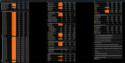

As an update, I just did a run of Intel Processor Diagnostic Tool and it passed the test. Below are the HWINFO readings:
