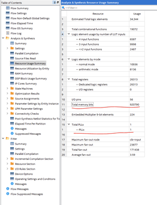

3)  I am using Quartus 18.1. In compilation report, I can see the total size of memory used, but I can't see the total memory available. For ROM, I have the same question.
4) in the following picture, Total PLL is 1. however, I didn't import PLL IP. why does it report 1 PLL used?
Valid and common question
Quartus sometimes inserts a PLL automatically even if you didn’t manually add one.
Reasons:
  • Clock source needs frequency conversion to meet timing
  • NIOS II debug interface or clock crossing domains
  • IP blocks internally require it (e.g., clocked video or SDRAM controller)
Summary: It's normal. Quartus uses PLL resources behind the scenes even if you didn’t explicitly configure a PLL.

ZhiqiangLiang
2,179 Views
I set RAM == 122880B, and ROM==81920B.
The question is:
I cannot set RAM + ROM = 540KB which you told me in this thread.
Even if I slight reduce RAM + ROM which is slight smaller than 540KB, I still encounter the size too big issue.
