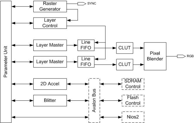

I&#39;m sorry but i can&#39;t quite follow you. Can you add a schematic that explains your system build? Mine looks like this for example
http://www.tembridis.com/image/fpga-gpu-impl.jpg (http://www.tembridis.com/image/fpga-gpu-impl.jpg)
