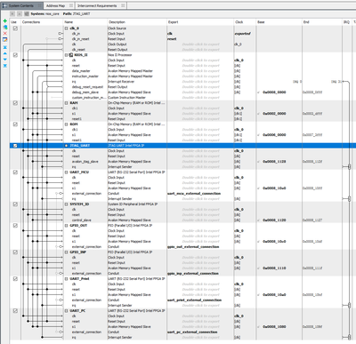

I am able to program/burn the jic file to Cyclone 10 LP 10CL120 via Quartus-->Tools-->Programmer, but I am not able to program sopcinfo and elf file via Eclipse-->NIOS II-->Flash Programmer.
I have also configured Eclipse-->Run-->Run Configuration, but I encountered the issue in the following picture.
The NIOS II in Platform Designer is designer in the following picture. I connect 40MHz crystal oscillator to FPGA AA12 pin which is dedicated clock  pin, and I didn't add a PLL in FPGA to multiple frequency.

The Nios II processor and other IPs typically expect a stable internal FPGA clock. A raw external crystal (not a clock module) needs a PLL or oscillator circuit to become a usable internal clock. Without a PLL, the Nios system might not run, hence causing the “Target is broken” error.
Fix:
Add a PLL (ALTPLL) in Platform Designer and configure it:
  • Input: 40 MHz
  • Output: a stable clock (e.g., 50 MHz or 100 MHz)
  • Connect this to the clock input of your Nios II system
Then regenerate the system and recompile your project.
Even if you have a clock input connected, if the FPGA fabric doesn't receive a valid toggling signal, Nios II won't start.
Test:
  • Add a blinking LED logic driven by the same clock to verify the FPGA "sees" a running clock.
  • Or use a SignalTap logic analyzer to probe clock toggling internally.
Run Quartus -> Tools -> System Console, then:
tcl, jtagconfig
bash, nios2-terminal
If the Nios II does not respond, it's likely not clocking or reset properly.
Verify:
  • reset_n to the Nios II and other peripherals is correctly connected
  • You’ve added a reset controller in Platform Designer
  • The reset source is active-low and held long enough during power-up
After regenerating Platform Designer system:
  • Go to Eclipse: Right click the BSP → Regenerate BSP
  • Clean and build the ELF file again
  • Then try to flash
Sometimes the Flash Programmer fails due to:
  • Missing or incorrect Flash controller connection
  • Try using Run → External Tools → Nios II Flash Programmer instead of Run Configuration
