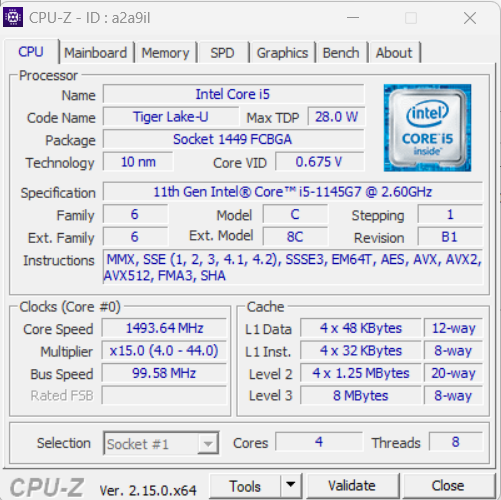

So this is my result, and here i put my task manager screenshot that taken while i do the dianostic. By the way. i've put the CPU workload in OS to High Performance and i didnt find Intel setting in BIOS. If u can, can tell me how to go deeper to BIOS?
Hello MorpKnight,
I would like to clarify that processors do not run at their maximum frequency all the time. The processor automatically selects the best frequency depending on the workload demand. However, in this case the CPU is running at base frequency, that is the reason why it seems to be that the Turbo Boost was disabled; in order for you to check the BIOS settings of your system, you need to check with the OEM (Lenovo) for further help.
The Intel® Processor Diagnostic Tool shows the CPU is working fine with no errors detected, can you also please provide the reported speed by the Intel® Processor Identification Utility? You can send the report either in a screenshot or .txt file following the instructions here.
Sebastian M
Here i provide my report file of Intel processor Identify. it shows 1.6GHz, when doing heavy task, and provide 3.4GHz when doing light task. I still confuse why my system make the speed of CPU lower when doing heavy task like playing games, i play Genshin Impact and R6 and it run at 1.6GHz
