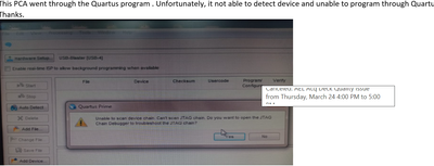

Programming device validated and ABUS failure found no voltage at enable +12p5V_EN from FPGA expected 2.6V measured 0V

May i know how do you program the MAX 10? DO you get error message if using quartus programmer?

Below is the snap shot of the error.
Encounter programmer fail during on JTag scan chain due to unable to detect the device.
