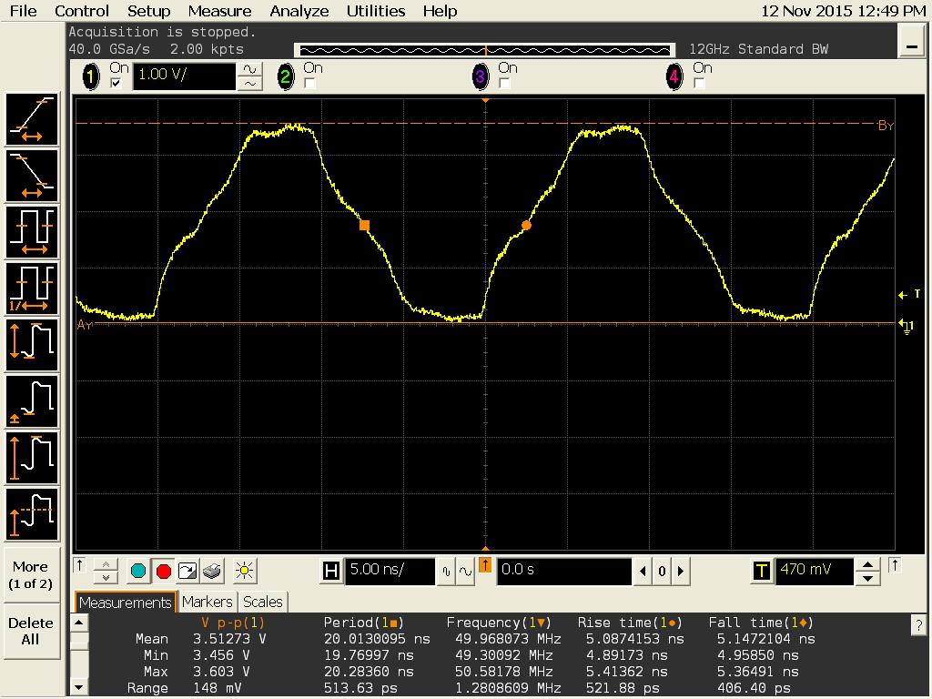

I'm debugging a Cyclone IV E design. The DDR2 interface is dead in hardware but simulates okay. Signaltap shows two out of three DIMM clocks dead. I scoped the 50 MHz reference clock and the rise and fall times are larger than the high and low time (about 5ns each). The external oscillator drives six (!) clock inputs so rather heavily loaded.
Would an ALTPLL instance have trouble locking onto a reference clock with too low slew rate? I have not been able to find any official information directly from the Altera documentation. Also, the engineer has incorrectly assigned the clock locations. The positive and negative signals in the pairs are not in adjacent locations giving these warnings in Quartus II: Warning (176684): Unable to place CK/CKn pair mem_clk[2] and mem_clk_n[2] on a differential pin pair because they have been assigned to incompatible pins not belonging in the same pair Warning (176684): Unable to place CK/CKn pair mem_clk[1] and mem_clk_n[1] on a differential pin pair because they have been assigned to incompatible pins not belonging in the same pair Warning (176684): Unable to place CK/CKn pair mem_clk[0] and mem_clk_n[0] on a differential pin pair because they have been assigned to incompatible pins not belonging in the same pair I'm trying to figure out if the current board can be made to work or if the engineer has to re-spin the board with corrected clock locations. Thanks!Enlace copiado

Yes - a number of the factors you mention may adversely affect the ability of the PLL to lock. A poor slew rate will affect the perceived high/low time ratio the PLL sees, which it will care about. Point of note: is your oscilloscope up to measuring this accurately? Using a scope with an unsuitably low bandwidth will also have this effect, even if the wave shape is in fact good.
Having six loads on the oscillator is also going to affect the wave shape and could easily cause the PLL further locking problems. Does the PLL report it has lock? You can implement the PLL with such an output signal, typically available by default. Try unloading the oscillator. Can you remove some of the loads? This will need to be done carefully so as not to leave stubs. You may end up having to cut tracks to do this effectively. As for the poor clock pair selection - only a re-spin is going to solve that. However, a bit of a long shot but - depending on the signalling standard of your clock source, you may find that one half of your differential clock could be used as a single ended input clock to the FPGA. Cheers, Alex- Marcar como nuevo
