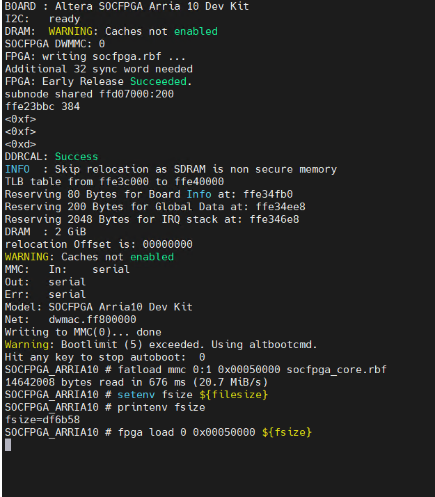

Hi Aik Eu,
yes here is a boot from SD-Card with my old bootloader and config files placed at sd card.
so i have 2gb of DDR Ram but only after FPGA config.

Hi TG_GER,
Sorry for the late reply.
From your logs, the socfpga.rbf is configured where the 2gb ram is available for HPS usage. You proceed to load the core.rbf from the sd card to the ram address 0x50000 then with fpga load to configure the core.rbf.
The socfpga.rbf should be the periphery.rbf. Configuration of periphery: this allows HPS DDRAM to be brought up, and must do be done in SPL
The ddr which is used by the HPS is normally determined in Uboot fsbl in the early stage which is in your case is the 2gb ram.
