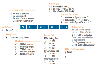

There is a three page document "Altera Device Package Information" (copy att.) that shows two options for solder ball composition for the 5CEFA5U19I7N part: "Regular" is 63% Sn/37% Pb and "Pb-free" is 3% Sn.
How does one specify the solder ball option when ordering this part? Thanks!

Sorry for the dela, for your information, the one that specify the solder ball option when ordering is the suffix. For an example 5CEFA5U19I7N. The N suffix is PB-Free packaging.
Hope that answers your question.
Nazrul Naim

Thank you for the help with my case. I understand from your reply that the "N" suffix specifies Pb-free packaging. Would ordering the part without the "N" suffix - that is, ordering the part number 5CEFA5U19I7 - result in parts packaged with the 63Sn:37Pb solder ball composition? This was an option highlighted in a package information document (copy att.).
