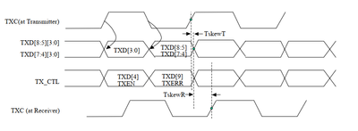

TX Timing
Examining the RGMII 2.0 spec:  (see attached)
At the transmitter, TX_CTL & TXD are sent edge-aligned to TXC by the transmitter.  However at the receiving end, the TXC signal is center-aligned to data.  According to the spec, the skew can be achieved by PCB trace routing or by an internal delay in the transmitting or receiving node.
Assuming the following:
  • With the HPS we can’t add 2.0 ns of delay to TXC
  • The customer hasn’t added the skew via PCB
  • All tracks on PCB are delay matched
  • Paths are delay matched within the PHY package
Then the only option is to add the delay within the PHY.
Here’s what we publish wrt TX:
The PHY allows for internal delays on TX_CLK via MMD register 2.8.  The goal would be to center-align the signals to TX_CLK by delaying TX_CLK.
As a default, the PHY adds a 15*0.06ns = 0.900 ns delay to TX_CLK.  However to center-align, TX_CLK should be delayed 1.65 ns.
Therefore if the customer sets MMD register 2.8[9:5] to int(1.65/0.06) = 27 or 1.62ns.  This will provide a Tsu of 1.47 ns and Th of 1.53 ns.  This should easily meet the TsetupR & TholdR requirements of 1.0 ns.
