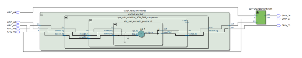

Then I added this component to my .bdf file like this (I added the input and output pins because if I put a constant value in a and b, then Quartus would have optimized it away, I also did the same in my other attemps with the CARRY_SUM primitive and the 4 bit adder) :
After the compilation, the chip planner gives me this result :
And finally, the RTL viewer looks like this :
As you can see, Quartus does not recognize it as a carry chain.

So here is my RTL view with the 4bit LPM_ADD_SUB,
And here is the chip planner view :
For the RTL view, it looks the same as the 1bit version (with 4 bit instead of 1 obviously), and on the chip planner we can clearly see that the carry chain is used, even though some optimization seems to occur as we only use 3 ALM.
