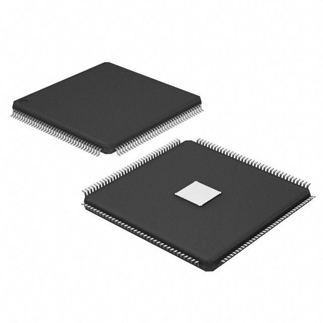

The package for this part has a ground tab (see this picture on the Digikey site):
http://media.digikey.com/renders/altera%20renders/ds-144eqfp-1_2.jpg Others that have posted a similar question to yours failed to attached the ground tab to ground. Because your schematic symbol does not show the ground pin numbers, its not possible to determine if that is your issue. Cheers, Dave- Mark as New
Thanks for the hint, but I soldered the part (including the exposed tab) with a reflow oven.
Greetings Thomas- Mark as New
--- Quote Start --- Thanks for the hint, but I soldered the part (including the exposed tab) with a reflow oven. --- Quote End --- Ok, onto the next likely candidate. MSEL pins should be tied to VCCA or GND. You have tied one to VCCIO. Cheers, Dave
