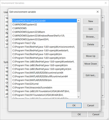

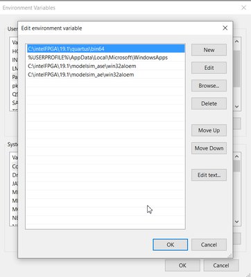

xtr
2,963 Views
Hi all,
I get the same problem, though I added C:\intelFPGA\19.1\quartus\bin64 to System Environment Variables.
I am using Windows 10, Quartus 19.1 and Matlab R2020b.
I am grateful for any help!
