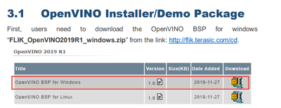

Additionally, I'm currently using OpenVINO 2019R1 due to FLIK's installation requirements, which include the OpenVINO BSP and Toolkit 2019R1 for Windows with FPGA support. Since all related packages are tied to this specific version, I'm concerned about compatibility with newer versions.
Is there a path to upgrade to a newer OpenVINO version while maintaining support for the FLIK driver? As far as I understand, the driver may be tightly coupled with the BSP provided for 2019R1. Also, does the newer version of OpenVINO support INT8 precision for FPGA inference?
[Packages installed]
Then later on is the openvino toolkit
Have contacted Terasic and they direct me to here. Appreciate for any helps.
