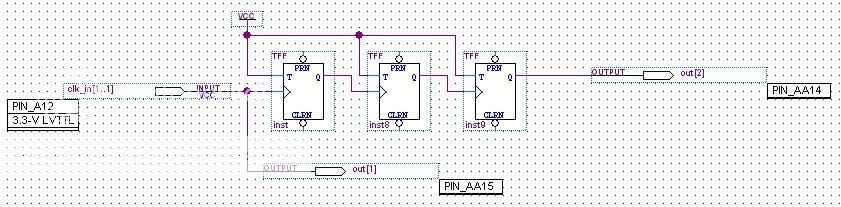

Hey All,
I have an interesting issue. I have a EP2C35F484 FPGA mounted on a FireflyII board (adds some memory, an oscillator, serial configuration chip and max232 converter). I am able to load a NiosII core onto the FPGA and run a simple counter but when I try to do anything in VHDL, even the simplest core does not seem to run. For instance, (using the schematic design mode) I simply connect an input to an output, assign the clock to the input pin and then assign the output to a physical pin on my board. As I understand it, I should see the clock being output to the physical pin, yes? I'm using the JTAG usb blaster to load the core, not worrying about the serial configuration chip yet. This seems like a very simple task but its really getting me stuck, especially because the NiosII core seems to work just fine. Any suggestions?

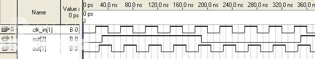

In my design I used the same output pins that were used in the working NIOS project. I just did a timing simulation and was able to see that my counter was working as expected. I've attached the schematic and the results below.
http://i560.photobucket.com/albums/ss46/creeg2/schematic.jpg
http://i560.photobucket.com/albums/ss46/creeg2/simresult.jpg

on the schematic I don't see any reason, why it should not work. Can you post the whole project?
What kind of Quartus version did you use ? If you have a version which includes signaltap,
try to tap one of your internal signals in order to make sure that the design is loaded.
Kind regards
GPK

So it appears there is a problem loading the design onto the FPGA. When I tried to use signal tap on my design, Quartus responded saying "Error: Can't find the instance. Download a design with SRAM Object File containing this instance.".
I suppose this means the design is not being loaded. When I ran SignalTap on the NOIS design I was able to see all of the output signals without any issue.
So I guess this means the question has now moved to what is wrong with loading the design to the FPGA. I'll try to look for some differences between the NIOS design and my design but I definitely could use some guidance.
Thanks for the signal tap hint.
