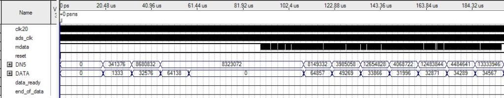

We have chosen the AD7401 Sigma Delta modulator for our project, translated the Verilog code given by the datasheet into VHDL and are now confused about the results of the simulation. We have attached our translated VHDL code plus the datasheet of AD7401. 1) We will give the master clock from the FPGA to the ADC from one of the I/O pins. The clocks don't seem to be synchronized though, there is a 5nsec latch delay. Should that be ok, or do we have to eliminate that delay somehow? 2) We tried to simulate the data flow inputting only ones '1', but result is really not the expected one. (DATA samples should be at the highest level?!) Yes, but what about overflow? The given interface is permitting that, if such a case comes up. Below are some results of a random inputted bit stream and a only '1' bit stream. http://i252.photobucket.com/albums/hh3/unoturbomk2/samples.jpg http://i252.photobucket.com/albums/hh3/unoturbomk2/samples2.jpg *** Is the code correct? *** We'd appreciate any kind of help! Thanks in advance!Link Copied
The original Verilog code is an example of bad coding style, involving word_clk designed as a ripple clock, but it's basically working.
You have confused the code by an adder, that hasn't been there before and apparently act's as a kind of random number generator in your simulation. if mdata1='1' then
ip_data1 <= ip_data1 + '1';
else
ip_data1 <= ip_data1 - '1';
The purpose of this combinational code is to assign 0/+1 respectively -1/+1 to ip_data1, not to sum up anything.

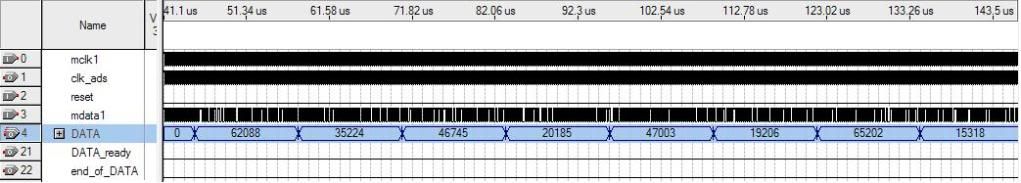

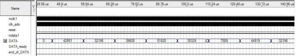

Ok, we tried to merge in some way the code of ADS1202 and AD7401, and we got really great results of the code which came out.
The first figure is with feeding 0's and then random input, and the second one is with 1s first and then random values. http://i252.photobucket.com/albums/hh3/unoturbomk2/2-3.jpg http://i252.photobucket.com/albums/hh3/unoturbomk2/1-5.jpg As you can see the code responses to the simulation quite well, respecting that it actually takes 2 words/samples for the code to respond to sudden changes of input values, due to the 3rd order sinc filter. The code is attached. If someone could confirm that this is correct, we'd appreciate it! Thank you!- Mark as New
The results are correct, except for the unhandled arithmetic overflow with mdata = '1'. I suggest to consider it in the code.
