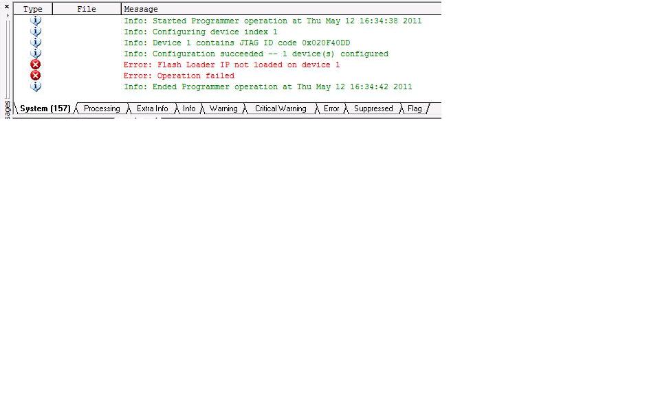

I have two identical boards, which have been working well for quite a long time. Then all of a sudden, for some unkown reason, one board can't be configured by its configuration device (EPCS16) after power up.
When I tried to re-program it using the jic file (this is the way these two boards got programmed in the beginning), I found I can't even do so. Quartus returns with an error "Flash loader IP not loaded on device 1".
I found there is no signal on DCLK during programming. Does that mean the FPGA is actually faulty?
The following is the message returned from Quartus programmer.
I really appreciate your opinion.
--- Quote End ---
Refers to the fact, that no configuration containing the flash loader has been loaded to the FPGA, or that a reconfiguration has been triggered somehow after loading it. The problem may be related to failing AS configuration, but not necessarily. I would check power supplies and circuitry connected to configuration pins in the first place.
