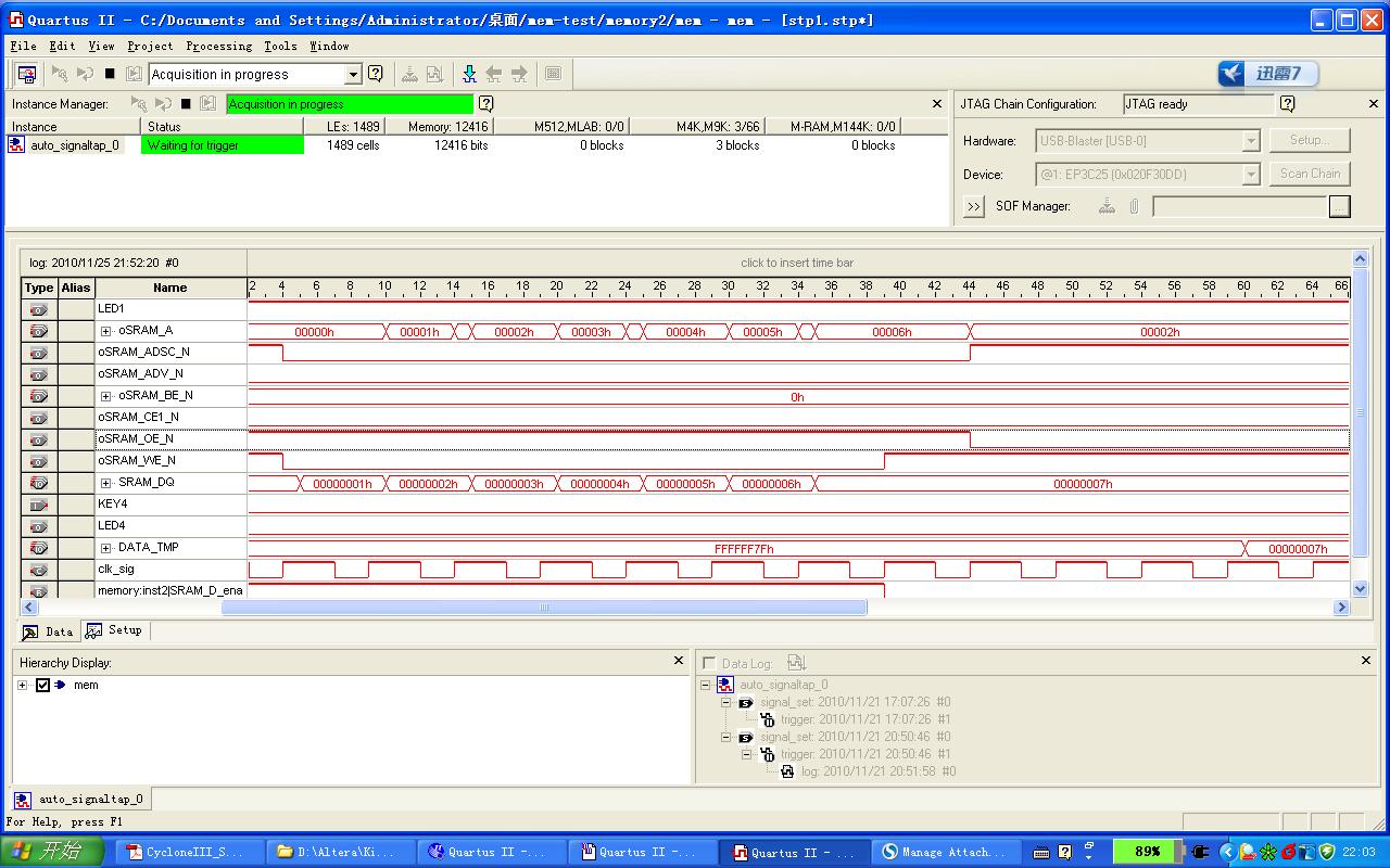

I am using a 10M sram_clk to write data to the ssram on C3-starter-kit board.
The inside clk has a 180 degree phrase compared to sram_clk.
I wrote data in single cycle and read in three cycles.But what i got from the read in register is not what i expected.
I can not find error in my code.Can anybody help?This has been bothering for a week.Thank you.
The attached file is the stp file.

Altera_Forum
622 Views
I haven't checked the datasheet, but shouldn't you keep ADSC low for one more cycle so that the SRAM gets your new read address?
Altera_Forum
622 Views
--- Quote Start ---
--- Quote End ---
Thank you,Daixiwen
Yes,i got right data when i keep ADSC low before read.
The ADSP_n is pull up to high.I thought i could use single read model,but not.I got right at pipelined read model.
