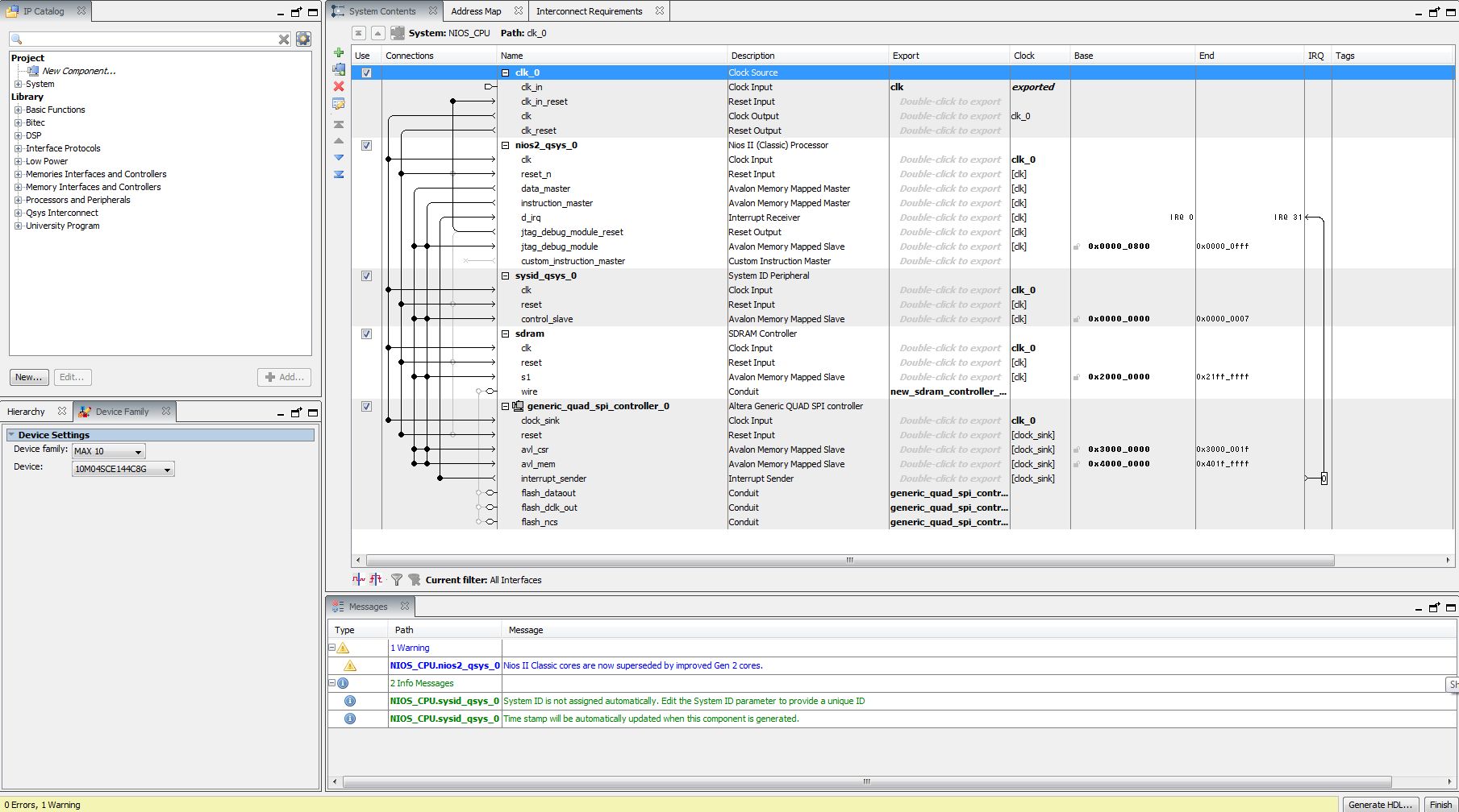

I already set configuration at below
Assignment -> Device -> Device and Pin Options -> Configuration -> Single Uncompressed Image
After I tried to compile Quartus show error like below.
Error (16021): You specified a configuration mode that includes memory initialization, however memory initialization is not supported by the selected device. In the Device and Pin Options dialog box, choose a configuration mode without memory initialization.
This is my Qsys setting (I do not add any on-chip memory)
http://www.alteraforum.com/forum/attachment.php?attachmentid=11385&stc=1
Does anyone success for boot nios from compact feature device?

This reminds me of another similar post recently...
[url]http://www.alteraforum.com/forum/showthread.php?t=49917 (http://www.alteraforum.com/forum/showthread.php?t=49917)[/URL]
Try changing your configuration mode to 'Single Uncompressed Image with Memory Initialization'.
