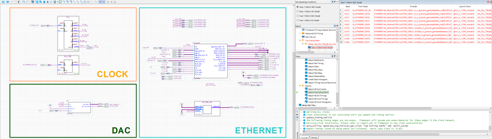

Finally me and my colleague "successfully" recreated the issue in a simple test project.
The project on its top-level consists of three parts - CLOCK, ETHERNET and a simple DAC part.
CLOCK consists of two PLLs, first PLL is for all clocks used in project, and second is for RX part of ETHERNET only, it receives rx_clock from TSE rx and in Source Synchronous Mode outputs clock for latching the RX data to the appropriate I/Os.
ETHERNET consists of triple speed ethernet core and DDIO for TX clock output.
DAC consists of a very simple bunch of code, and the most interesting thing is that it is clocked by 200 MHz clock by default.
So the issue which I mentioned in the beginning of that post was recreated.
We also found what action should be done for the issue to disappear - we changed the source clock for DAC part from 200 to 100 MHz and the result is on the picture below:
So the interesting part of an issue is that there is another block whose source clock comes from another PLL has an impact on timing (in particular the I/O internal delay values). As I previously mentioned we can correct I/O internal delay values manually and obtain the correct timing.
 I attached the project.

IDeyn
New Contributor III
2,487 Views
Hi Anand!
Thank you for your answer.
In my second post I wrote that I can manually set the delays in order to meet timing.
So the question was what is the reason for Quartus engine not to choose delay settings in order to meet timing.
It is strange, isn't it, that Quartus sets the delays so timing fails, but you can manually choose the right values for timing to pass.
And the main part of question was - Quartus almost always chooses right values, except in the project I attached.
The small changes in the project, as I mentioned, lead to right values in delays which Quartus choose.
I thought that maybe it is a bug and our project could be helpful for the team to fix it.
It is strange and probably a bit useless if need to check correctness every time and manually set delays.
In our test project case we can show that Quartus automatically chooses delays which lead to perfect slacks in both setup and hold.
So it is arguably that Quartus chooses delay values and as you said "does not automatically set delay elements to maximize slack".
And I also asked for the root cause of the problem.
Ivan
