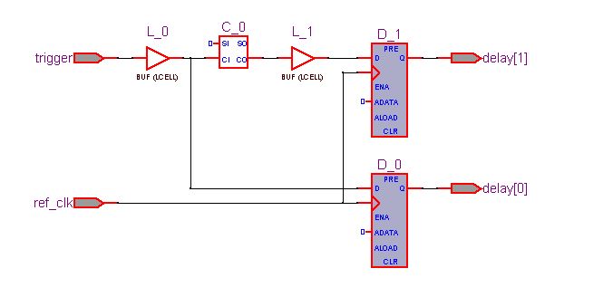

I'm trying to implement LE carry chain using low level primitives.
L_0:LCELL
PORT MAP (
in0,out0
D_0:DFFEAS
PORT MAP(
d=>out0,
q=>delay(0),
clk=>ref_clk,
ena=>'1',
clrn=>'1',
prn=>'1',
asdata=>'0',
sclr=>'0',
sload=>'0',
aload=>'0'
C_1:CARRY_SUM
PORT MAP(
sin=>'0',
cin=>out0,
cout=>carry0
L_1:LCELL
PORT MAP (
carry0,out1
D_1:DFFEAS
PORT MAP(
d=>out1,
q=>delay(1),
clk=>ref_clk,
ena=>'1',
clrn=>'1',
prn=>'1',
asdata=>'0',
sclr=>'0',
sload=>'0',
aload=>'0'
I've attached what I receive in RTL Viewer. It's seems like something I want to achieve, but CARRY_SUM primitive is ignored. It's my first contact with primitives so I guest I'm doing something wrong. Particularly I don't know what is sin and sout in CARRY_SUM and how to use it. My intend is to create 64 LE length delay line (and then TDC- time to digital converter). I'll appreciate some help. Device is Cyclone III. I've noticed it should rater be I another forum category, sorry.
1. The RTL apparently belongs to a different VHDL source, cause the instance name of the CARRY_SUM instance is different.
2. Apart from this, it's completely matching the code to my opinion. I don't see, what should be missing. 3. I don't understand, how carry sum is related to logic cell delay line and what you want to achieve with the shown code.- Mark as New
I'm trying to achieve delay chain as shown here:
http://www-ppd.fnal.gov/eedoffice-w/projects/ckm/comadc/wavelettdc_abs08.pdf (picture 1a) I'm doing it completely wrong? How would you do it? edit. Ok, I figured it out. CARRY_SUM documentation should really be better.- Mark as New
I've been yet implementing delay chains in logic cells by applying keep attribute to wire signals, as described e.g. in the stratix cookbook (Advanced Synthesis Cookbook). It's straightforward and works with all FPGA families without considering internal details.
I see, that a TDC design (combination of delay chain and DFFs) could utilize carry chains to achieve a compact structure and (hopefully) small delays. It's most likely possible by device specific WYSWYG LCELL primitives. The cookbook has some Stratix examples with direct definition of carry chains. But I never used this. I was basically able to place and connect cycloneiii_lcell_comb elements in a design, that have been kept during synthesis. But I don't yet know the binary LUT_MASK coding necessary for a meaningful logic function.- Mark as New
