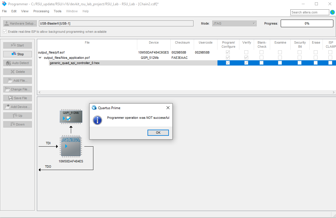

The steps followed are:
1. Program the FPGA with pfl.sof (successfully)
2. Program the Nios II firmware into QSPI Flash (this is NOT successful).
As a conclusion, the QSPI Flash doesn't get programmed and the RemoteTerminal does not execute the code from remote_update.c
Can anybody provide a correct nios_firmware.pof?
Also, the file softwarearchive.zip is missing from the RSU project. It is needed to manually create nios_firmware.pof
EP1
2,189 Views
Picture from the previous fail when programming QSPI Flash

Just a quick check, is both .pof and .hex are generated from the same design?

They both come from the package provided by Intel, so I would assume so.
MAX 10 - MAX10 Remote System Upgrade (RSU) over UART for Nios II Processor (intel.com)
One the project is compiled, the files pfl.sof and Nios_application.pof are saved within the folder "master_image".
They are both ready to use as don't require compilation.

I will check from my side, have you done any RSU example before? Have you check your MSEL pins for configuration?
EBERLAZARE_I_Intel
2,034 Views
Could you try generating your own .pof and try to program your own .pof?
You could try to use the app1's .sopcinfo, build it to get the generated .hex to build the .pof as per the document. Then try to use that.

EP1
1,974 Views
Have generated all on my own and it works now.
Thanks.
