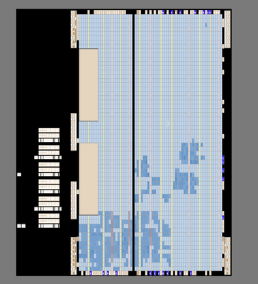

"I don't know if this is related. I observed in the chip planner that all the logic layout is concentrated in the bottom left corner, leaving many resources unused, yet my pins are distributed on three sides. Congestion occurs even when there are still many resources remaining."
The image below is a report of routing utilization.
The blue areas in the image below represent the pins I have actually allocated.
Can routing failures be resolved by optimizing the code without changing the timing constraints?

I found that changing the initial placement seed seems to solve the problem. However, I still want to know how to avoid this issue by modifying the code?

You can check whether the clock frequency in your design is relatively high, and whether there are signals with large fan-out and large data bit widths. These factors can lead to concentrated routing

You may try to disable the "optimize timing" setting in Advanced Setting (Fitter) and see if it will help the routing process.

Thank you for your reply. I tried your suggestion, and it indeed helped with the layout and routing, making some previously unsuccessful routings successful. However, it worsened the timing. This might be an area where a trade-off is necessary.

Yes, indeed. Additionally, 400M is somewhat high for Cyclone V, making it challenging to meet both layout and timing requirements simultaneously
