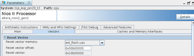

I have a reference NIOS project in which the reset vector memory is selected as an external flash. I opened platform designer and found the following information. Picture attached below.
Can you help to answer my following questions?. I did go through the embedded handbook, and NIOS user guide but could not get a specific answer. Can you help?
Q1) Why is the "reset vector" field greyed out here?.
Q2) Which address will be taken into account for the reset vector?. 0x08b0_0000 (or) 0x18b0_0000?
Hi MK,
Greetings and welcome to Intel's forum.
There is not specific reason why it is greyed out. It is according to the base address you set in Platform Designer. You have the flash address set to 0x10000000, and the offset to 0x08b00000. Therefore, flash will start access at 0x18b00000.
Hope this clarifies your doubts.
Thank you.
Kelly
It's based off the base address you set in Platform Designer. So it looks like in PD you have this flash set at address 0x10000000. You set the offset to 0x08b00000, so the Nios accesses the flash starting at 0x18b00000.

1) As already stated, the flash in your system starts at 0x10000000 and verified in the address map you've shown. The offset you've selected for the reset vector must be within the range of the flash, and it is. The board test system is a completely different design so its setup doesn't apply to your design. Addressing is specific to the host you connect to, in this case, the Nios processor.
2) This is the address where the Nios will start running code from. It doesn't do anything to the flash. The flash (or whatever memory is attached) must be set up appropriately to start running code at that address. On the dev kit, the flash is already configured though you can change it if you want to using the flash programmer tool in Quartus.

1) You're getting the programming bitstream and processor code mixed up. You must have a .pof or something in some non-volatile memory to program the device itself and then you need the Nios processor code stored somewhere else, pointed to by the reset vector, to start running that code when the processing starts (or is reset).
2) You're forgetting the CE signal. And the 0x10000000 is the base address in the system design, not a physical address on the flash. That goes back to the offset value to access the physical location on the flash.
3) No, starting location of code.
4) Your code is running directly from Eclipse (debug mode) over the JTAG connection. Eventually, you have to put the code in flash (or wherever specified by the reset vector).
