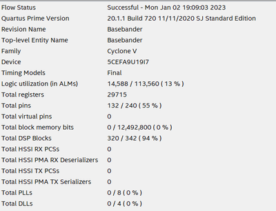

I have been slowly developing my FPGA code, and up until now, I have had no trouble fitting it into a POF file, but now I'm getting this message.
I'm developing for a Cyclone V (5CEFA9U19I7) and I'm booting from a EPCQ32A.  The program doesn't come close to using all of the resources on the Cyclone V (with the exception of the DSP blocks).
Using a different configuration chip is not an option.
Is there some optimization that I can set to make the output more compressable?
I've tried to optimize for area instead of speed and that didn't seem to work.
It doesn't look like I'm using alot of the device resources.  What can I do to get this to compress to a 32Mbit POF?

why .pof? Presume you are using EPCQ32A in active serial configuration, respective programming file is *.jic. Compressed image size is equal to .rbf size (if compression is selected in device options).
Compression for converted file has to be separately selected in programming file conversion tool under options of the respective .sof image, may be you missed this step. Maximal uncompressed A9 image size is about 100 Mbit, so I'm not sure if it your design can fit 32 Mbit.

Guess it doesn't work. I see already 30 Mbit image size with A9 and 4% ALM utilization. Need 64 Mbit flash.

If I eliminate one stage of FIR filtering (using 20 hardwaree multipliers) it works.  I can compile and it will produce a POF file that loads.
Changing to the EPCQ64A is problematic because it is a 16 pin soic not an 8 pin soic.  I could probably scab one on but I think I'll try to reduce my multiplier usage by changing the number of taps in my filters.
