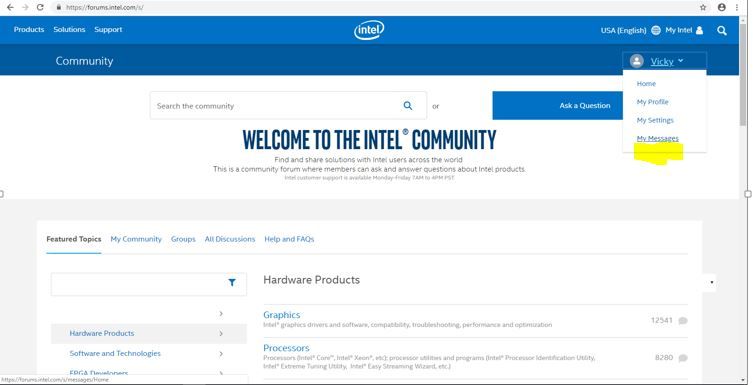

if possible please provide the project file, that will help us to better support.
if you don`t want to share it in community, you can use "My Messages" option to share with me. My_messages.JPG
