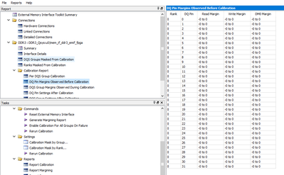

I tried to run EMIF toolkit (in Quartus 13.1), the memory connection is:
The summary report:
Interface details:
DQS group masked
DQS group calibration
DQ Pins margin before, during and after calibration are 0
Based on your report, the issue is related to DDR3 calibration failure.
Please check the point below to debug this issue: -
- Check the button/switch or any trigger port on board that controlling the reset pin for DDR3 EMIF IP. Make sure it's not hold in reset.
- Have a standalone DDR3 example design to debug the calibration issue.
- You can generate from the DDR3 IP that match your board and memory setting.
- Make sure the pin placement of the DDR3 design is matching to the board.

Can you generate the example design in latest Quartus release? because the Quartus 13.1 is already EOL.
The previous snapshot that you have shared when using the EMIF Debug Toolkit has shown the device used is 5CESBA6.
Maybe you can double check the device used in the design and make sure it's matching to the FPGA device on the board.
I highly recommend using latest Quartus version to debug the DDR3 issue as the issue might be with the tools in Quartus 13.1.
Another suggestion that you can try is to lower the JTAG frequency to 6MHz in the Programmer before downloading the sof file into the FPGA device.
You also can check the timing report and make sure the design doesn't have timing violation.
