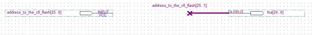

I found a problem when i try to connect the pin in .bdf file~
This is part of my verilog file
output [24:0] fsa,
wire [25:0] address_to_the_cfi_flash;
assign fsa = address_to_the_cfi_flash[25:1];
My problem is that how can i connect the [25:1] to the pin with [24:0] in a bdf file ?

Draw a wire from fsa, click right on it, and on the name type "address_to_the_cfi_flash[25..1]". The connection is made !
The join picture illustrates that.
Jérôme

Thanks! I made it!
