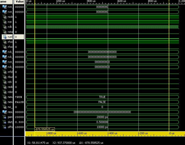

sir, i have moidfied my code as per youe advice .but in waveform i get "0 " values for iput & output. i have done the simulation for 1000us.plz help:cry:.i have attched the output waveform . code is here...

file:///C:/Documents%20and%20Settings/Debolina/Desktop/wvft.JPG

I have used that code style for a decade and it always works.
Now, is your file there and correct format. Are you looking at first node that acquires data from file... you need to follow the problem step by step.
Altera_Forum
560 Views
does "infile1.txt" exist? is it being read correctly? with your code, if there is a problem with the file there is no message telling you this, it just skips the input code.
Try adding this to your infile process:
assert (not ENDFILE(inFile) ) report "Reached end of file or there was an error" severity failure.
also, with your code, a meta value on the input_tmp would return a 0 to rxn_re.
Btw, its a bad habit to leave large bits of code commented out.
And Please use the code tags around your code next time.
