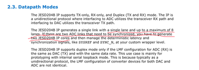

If the device clk and sysref of the two ADCs from a same clock chip, and I configure L M F = 2 8 8 for each ADC, I need to instantiate two ip cores and configure L M F= 2 8 8. Why cannot I instantiate one ip core and configure L M F = 4 16 8 ?

Regarding to your question, If both share the same IP, there is no mechanism to check and ensure that the data are aligned. The data transmitted by the two ADCs will not be synchronized, high likely will arrive at different times. With multiple JESD IP, even if data can arrives at different time, there is a mechanism to ensure the RX IP data can align and then achieve synchronization behaviour.
The below concept is for JESD204C, which is applicable to JESD204B too.
ScreenshotScreenshot
Hope this answers your question.
