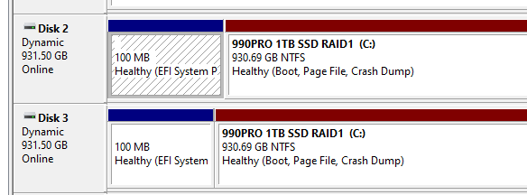

I created a mirrored boot drive already using Windows. But first, I used Samsung Magician to perform a data migration from the still bootable SSD to a new one. It's really a data clone since the data remains on the old SSD. Anyway, the migration created all of the partitions (EFI, Recovery, Boot as well as the reserved). I made sure the drive was a GPT drive in Disk Manager and then verified a few things using diskpart. Then I used the 'bcdboot' command to make sure the proper information was copied to the EFI partition. I first had to assign the EFI partition a drive letter though. Once the 'bcdboot' command was complete, I removed the drive letter from the EFI partition.
The final set of steps was to make the new drive a dynamic drive and then create the mirror. It's been running fine for two days now. I get a message each morning from Magician warning me about the failing SSD and asking me if it can send info to Samsung. And the AMI BIOS still reports the same SSD as having imminent failure. So, for now I'm covered. When I boot I get a windows screen that gives me a choice of booting into Windows 11 or booting into a secondary OS (the mirror drive). Screenshot below shows the mirrored boot drives. Drive 2 is primary.

Once you have the mirror created in Windows, using regular windows disk management, you get a blue boot screen on startup that gives you the choice of booting up from the regular Windows system, or from the 'Secondary Plex' which is the mirror. It defaults to the regular Windows system after 30 seconds or you can just hit 'Enter'. I would imagine that if the primary were unavailable, it would boot from the secondary plex automatically. Haven't tested that scenario.
