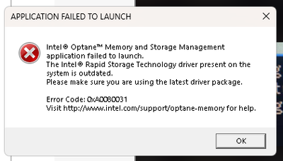

Optane Memory and Storage Management was throwing application errors, but I figured that out - the current version in the Window store does NOT work with the 17.x drivers and option ROM. Period. And believe me I tried every darned combo.
So I rolled the software all the way back to the versions installed from the original driver ISO for my Lenovo P330 (the driver and app are in folders K1RAD63US14 and U1RAU12AP17.) And that was the ONLY combination where the RST Optane app would even load without throwing application errors.
With the software now apparently working again and Device Manager showing the RST is on driver 17.11.3.1010, I can finally get back into the RST app...

And, the minute THAT goes on the PC, then I get this when I try to use the software no matter what driver's installed.
ONLY the driver AND tool combination from the Lenovo recovery disk e.g. U1RAU12AP17 (per my very first message) work. See attached.
