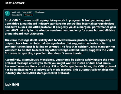

Hello all,
Can someone help me on this one
The device, Intel RST VMD Managed Controller 09AB, is reporting a bad status value. This device will not be available until the issue is resolved. The Plug and Play ID for this device is PCI\VEN_8086&DEV_09AB&SUBSYS_17311025&REV_00\3&11583659&0&30.
I encountered this from the perfmon report I ran recently. This is a new Acer Predator Helios Neo 16 laptop ..
Even Intel Rapid Storage Technology App's rescan button is not functioning.
Note. I also installed a new 2nd storage nvme m2 ssd  on to my laptop.
Kindly let me know how to overcome this issue or if this is negligible

Hello Abhilash_TJ,
To get a better understanding of the issue and be able to provide an effective recommendation, I would highly appreciate you sharing your system configuration so I can fully check your system components and provide you with an accurate fix. This could be possible by downloading the Intel® System Support Utility for Windows* software. When the download is complete, launch SSU.exe.
  • Click Scan.
  • Click Save (.txt). *Attach the log file as you reply.
I will wait for your reply.

JeanetteC_Intel
3,889 Views
Hello Abhilash_TJ,
Thank you for sharing the SSU log file. Please proceed with the steps below:
  1. Make sure the Intel RST driver is up to date. Contact your System Manufacturer or check in their website for the proper driver (look for IRST (Intel® Rapid Storage Technology) Driver version 19.5.7.1058) or contact their support team so they can guide you with the steps.
  2. If the issue persists, contact your System Manufacturer for further assistance.

Abhilash_TJ
3,816 Views
Hello Jeanette,
As you can see from the Driver Version it already seems to be in the one which you have suggested
JeanetteC_Intel
3,761 Views
Hello Abhilash_TJ,
Good day.
I understand that the recommended RST drivers and the currently installed have are the same version. Please try to uninstall and reinstall it making sure that the drivers are coming from your system manufacturer's support.
You may also try the generic Intel RST driver. Find the suitable driver depending on your processor's generation in the Download Center.
If the issue persists, try to contact your system manufacturer support team to get further assistance.
