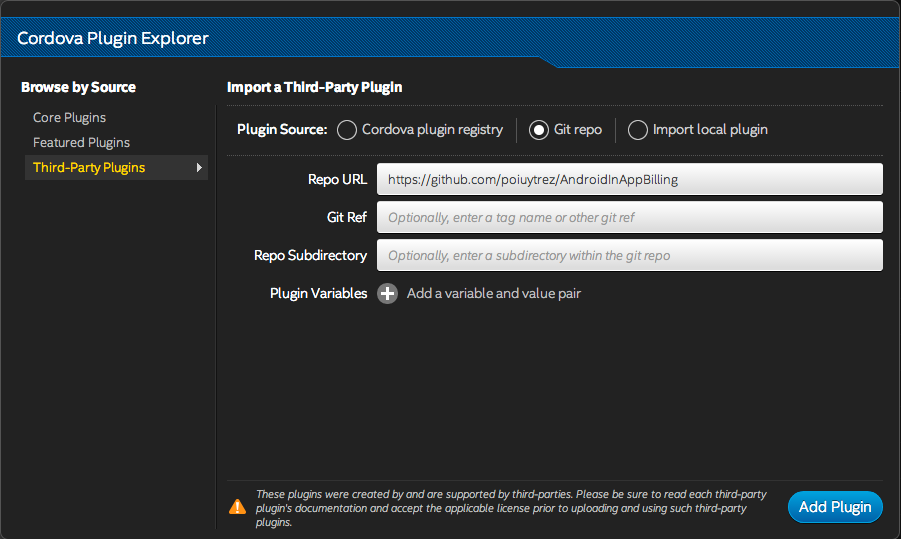

Hey guys. I managed to build my game on Construct 2 omitting the built-in In-App-Purchases function.
Now that I implemented it it required I fetched this plugin:
com.mcm.plugins.androidinappbilling from this repo: https://github.com/poiuytrez/AndroidInAppBilling
I did. That's when the first build failed. It says failed to install something called:
cc.fovea.plugins.inapppurchase
So I found this cc.fovea.plugins.inapppurchase, put in the necessary BILLIN_KEY and build failed.
Any solutions to this?

To add the cc.fovea.plugins.inapppurchase plugin I recommend you use the following technique:
I'm assuming you added https://github.com/poiuytrez/AndroidInAppBilling to your project by using the plugin manager and chose "third-party" and specified the git repo address, like in the following image? DO NOT use the intelxdk.config.additions.xml file to add that plugin.

Hey guys. I was able to find the solution from the C2 forums. Apparently the error originates from the C2 side. Upon exporting the project, a file called "additions.xml" is being generated and this thing is the reason the three plugins listed above are being cited even if they are not present in the project.
I was able to build successfully by erasing everything written in the "additions.xml" file and like you said choosing only one of the said plugins.
