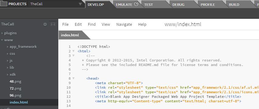

bharat_b_
2,842 Views
Hi Paul,
Followed the procedure mentioned in link.
Created a copy, imported a project, (checked "User Cordova Plugins" option while importing)
But the newly created project doesn't have Code and Design buttons, while the old one still has it.
Hi Paul,
PaulF_IntelCorp
2,842 Views
Bharat -- you must use a new project name to see the code/design buttons (and make sure you start with an App Designer template).
