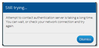

After installing the latest version, when I start the IDE, it tries to log in but fails with the below error.
I have rebooted and reinstalled the IDE, I still can't connect. I don't know if my company added group policy that blocks the destination IP for the authentication server - but I don't know what it is to check.
Any help would be appreciated.
Error:
Attempt to contact authentication server is taking a long time. You can wait, or check your network connection and try again.

Are you still experiencing user authentication issues?
It definitely looks like it is failing to connect to the authentication server. Can you try it from outside your company network? Maybe from home?
Account works fine from home. I can log into through the SDK and can even get to the old web App Center site at below URL.
I installed Early Access XDK (2682) and it appears to be working . The regular version still does not.
Although I never get a success page in the build, it just goes back to the build screen - but that's another issue.

Both versions work from home (Regular 2727, EA 2682). Only the EA version works from my office. Meaning, the account is OK - there is nothing wrong with the login. Work is where I am having the issue. I only mention using it at home to show that the account is ok.
The regular version DOES NOT work from work.
The EA Version WORKS from work.
I did not see issues until I installed version 2727

Hello Mike,
It looks like there are some proxy settings at your work that's stopping the authentication to go through. At the same time wonder why EA version works fine.
1. Why? They are in separate directories, with different executables and supporting files. Are you saying that you can't have a side-by-side installation? I haven't seen any issues before, and I've been running both off and on for a while
Two side by side installations are fine, but you cannot run two of them at the same time. If you are running both, please close both of them and start one only.
If your proxy settings are correct, it's possible that your installation of 2727 is corrupted? Please try to uninstall and re-install.
Independently, try to login at signin.intel.com from your work and see if that goes through. Please send screenshots of errors if any.

What I was looking for was help on where the XDK is trying to log into - what IP - so that I could get with my network guys and determine why it's not getting through.
Hi Mike,
Could you send xdk.log file from both your XDK and XDK EA install locations?
Mike, are you running on a Windows, Mac or Linux box? If on a Mac or Linux machine, you can setup the proxy in your environment and then start the XDK from the command-line. see this FAQ > https://software.intel.com/en-us/xdk/faqs/general#bad-proxy -- that may fix the issue.
I am on Win7 (as previously mentioned).
The latest version fixed the issue.
