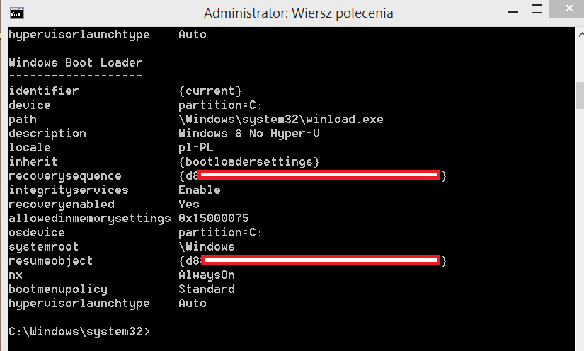

Hello.
I'm trying to install HAXM on Windows 8.1 Pro and every time I get the message "This computer meets the requirements for HAXM, but Intel Virtualization Technology (VT-x) is not turned on.". I have a ASUS K75JV notebook with Intel Core i7 3610QM processor and 8GB RAM.
I have tried all found solutions and it still won't install:
  • I have the latest BIOS for my notebook
  • VT-x and VT-d are turned on in BIOS
  • I don't have Hyper-V installed on my system
  • I've tried "bcdedit /set nx AlwaysOn" and reboot
  • Tried HAXM 1.0.6 and 1.0.7 (Win 8.1 hotfix)

Also I agree with this quote from Wojcech F., so same here problem. There solution doesn't fix my problem, so what i should do?
PS. I putted into here my screenshots and installation log. PC: Notebook Lenovo Y510p with Intel Core i7 4800MQ, 8GB RAM.

Uh, Now Installer HAXM Hotfix for Windows 8.1 has been done successfully! :) That's why happens after updating system using Windows Update.
Joshua_B_Intel
6,657 Views
Maciej, are you saying that you installed some Windows updates, and how the HAXM installer is able to complete successfully? That's very interesting, if true. Could you let me know for sure that's what happened (and a list of installed updates, if possible, would be great!). Thanks!
Maciej_P_
6,657 Views
Yep, On emulator app is working as much faster than before.
List of installed updates from 2014-03-18 :
KB2913760 - http://support.microsoft.com/kb/2913760/en (I think here is fix )
Other updates: KB2938527, KB2919442, KB2909210, KB2901125, KB2929961
