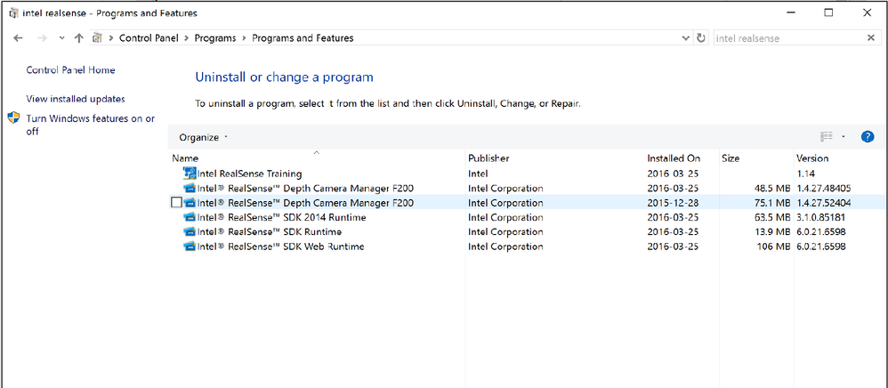

- Not sure about logs, but here are the error messages from the dialog windows of uninstall attempts of DCM, SDK, SDK Runtime and Web Runtime from Programs and Features (Windows 10 64 Pro):
"Intel® RealSense™ Depth Camera Manager F200 Setup Wizard ended prematurely because of an error(s).
To install this program at a later time, run Setup Wizard again. Click the Finish button to exit the Setup Wizard."
"Intel® RealSense™ SDK 2014 Runtime Setup Wizard ended prematurely because of an error(s).
"Sorry, there was an error during installation... close the installer and reload the web page to try again."

Here is another possible fix for error -4 on the F200:
- Remove any DCM that you have installed.
- Connect the F200 camera.
- Open Device Manager
- Under Universal Serial Bus Devices, uninstall Intel(R) RealSense(TM) 3D Camera (Front F200).
- Disconnect the camera
- Start the DCM installer
- Connect the camera
- It may now install the firmware this time.

It seems that an older driver release (DCM) will indeed work!  The older DCM (intel_rs_dcm_sr300_3.0.24.59748) will install without error and the SR300 will function with the latest SDK on an Intel Atom z8700 based Windows 10 (64 bit) tablet; albeit with some problems and errors with some of the example tools, and some slowness with hardware initialization.
Intel, since an older DCM driver works on an Intel Atom Z8700 system, it would be logical to have the latest drivers install on these systems. Will you be fixing the problems and update the DCM so we can support the SR300 on the Intel Atom z8700 with Windows 10?
Other info:
1. The camera is a peripheral (yes, USB3.0, and power settings enabled).
2. In Device Manager, what is listed under Imaging Devices?  RGB, depth
3. In Device Manager, what is listed under USB Devices as a RealSense camera? Yes, Intel(R) RealSense(TM) Camera SR300
4.  Are there any error codes : Setup Wizard ended prematurely because of an error(s). Windows Installer failed to configure product:Error message: Fatal error during installation. Error code:1603File name: intel_rs_sdk_runtime_ia32_dcmservice_sr300_3_1_25_2599.msi
5. Include install logs.(let me know if you need these)
Thanks! - Kim
