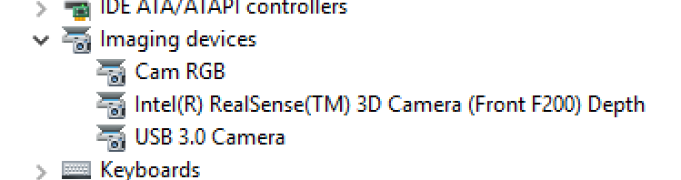

i've been trying to install f200 on usb3 ports running intel_rs_dcm_f200_1.4.27.41944.exe on two different Windows 10 pro machines but keep getting this:
The installer failed to detect an Intel® RealSense™ 3D camera on this system. The installation was terminated. (Also attached capture)
on both machines device manager only shows Creative VF0800  under Sound, video and game controllers, but nothing under imaging devices.
any ideas?
Cheers,
Uzi
Xusheng_L_Intel
17,083 Views
Maybe the firmware in this camera is too old. Where and when did you get this camera? Could you provide a pic? Thanks!

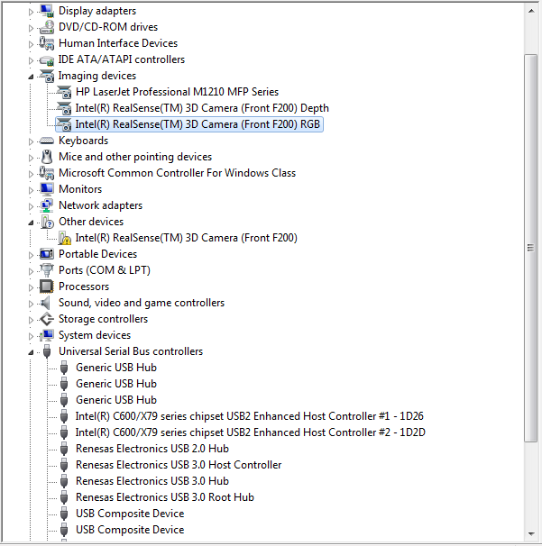

When installing DCM 1.4.27.41944 I receive:
USB3.0 Host Controller driver is required for Depth Camera Manager Installer to continue. Please download and install the Intel® USB 3.0 eXtensible Host Controller Driver from below location and restart DCM installation.
Using Renesas USB 3.0 controller. The intel recommended drivers are for C610+ is there no support for the C600?
kelly_t_
17,083 Views
Ok am in the same boat as the rest of you all but all the software installed good its just wont turn on or not connected i getnder
not connected it say under  camera explorer but under the driver manger is show ok and all the installed went fine it just not turning on
and it the f200 camera  DAM IT  I NEED  windows 8.1 or higher i have windows 7 64
i got a bad camera each got it to work one or two times then it stops working keep disconnecting usb
