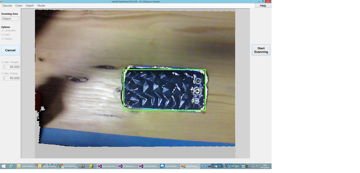

Hello. I am writing a c++ app for 3D scanning. I'd like to add modify the image i get from
PXCImage* image = scanner->AcquirePreviewImage();
or directly the QImage i create from
QImage* qimage = new QImage(imageData.planes[0], width, height, QImage::Format_RGB32);
to display the rectangle which rapresent the scanned area as in the image below (taken from the c# example). But I can't understand how it does it in the code! I am just missing some understanding of the sdk for sure, but I'd be grateful if someone could explain it to me.
(I am using the PXC3DScan::ScanningMode::VARIABLE if that could affect the process).

It will not support to draw scan boundary when you selected variable scan mode. We will provide this feature in the future release. Thanks!
