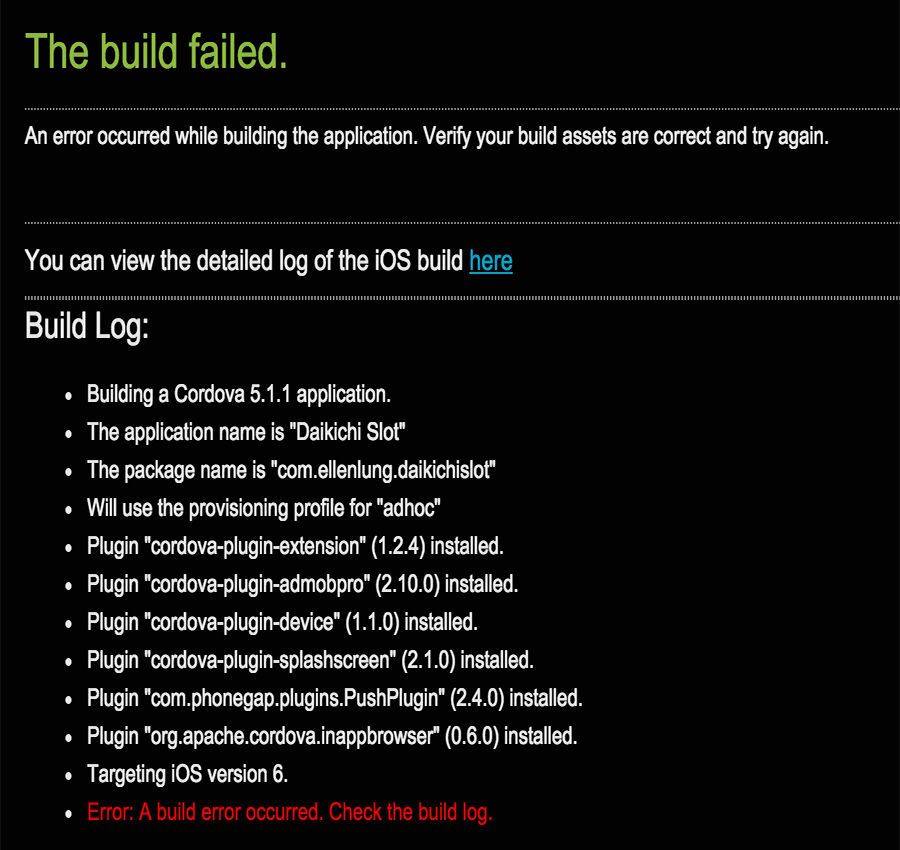

Hi there, I have successfully building few android app and 1 iOS app.  but when it comes to my 2nd iOS build in, it just failed.  I have got all the certificate and admob plugin, I do not understand why the first one work but the 2nd one is failed. please take a look on my attached . I have been spending the whole day to figure out why..  ps, My game is builded in Construct 2.

Like the red text in the first screen shot you posted says, check the build log.
At the bottom of the log, you will see this:
Check dependencies
Code Sign error: Provisioning profile does not match bundle identifier: The provisioning profile specified in your build settings (“Daikichi Slot”) has an AppID of “com.ellenleung.daikichislot” which does not match your bundle identifier “com.ellenlung.daikichislot”.
CodeSign error: code signing is required for product type 'Application' in SDK 'iOS 8.0'
** BUILD FAILED **
com.ellenleung.daikichislot             !=         com.ellenlung.daikichislot
so the build fails. They must match, this is how apple verifies things.

Look at the log, you will see lots of these lines at the end:
duplicate symbol l002 in:
    Daikichi Slot/Plugins/cordova-plugin-admobpro/GoogleMobileAds.framework/GoogleMobileAds(GADAdViewTouchGestureRecognizer.o)
Try removing any 3rd party plugins you have included, then upload build. This will help you determine what plugin is giving you issues.
